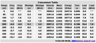

M700 + Trijicon Credo 2.5-15x42 + Caldwell bipod + muzzle brake should come in right about 10lbs.
Using JBM's recoil calculator for the 90gr AH going 3500 fps from a 257 Roberts, I get 8.8lbs of recoil. Subtract let's say 35% for muzzle brake reduction and you get 5.72lbs of recoil. Pretty darn mild considering bullet performance.

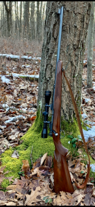

I am a sucker for a beautiful wood stock and metalwork on vintage rifles.
View attachment 1703195If you can find one, I would highly recommend the 250 Savage. Still rolls one or two most every year for me with Speer 87 grain hot cores. If you like classic cartridges, it doesn’t get much more classic than this. Essentially no recoil.
There ya’ go bringing a tear to my eye once again flaunting that gorgeous Pre-64. I can’t imagine what that one would bring on the collectors market. Too bad that they still don’t make them like that today.
