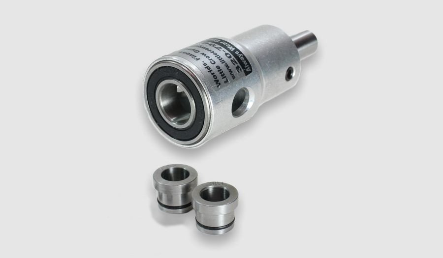

If you have a way to spin it, the Little Crow Gunworks WFT2 may be a good candidate. It registers off the case shoulder rather than the case head for what that's worth. Smokin' fast once it's set up.
