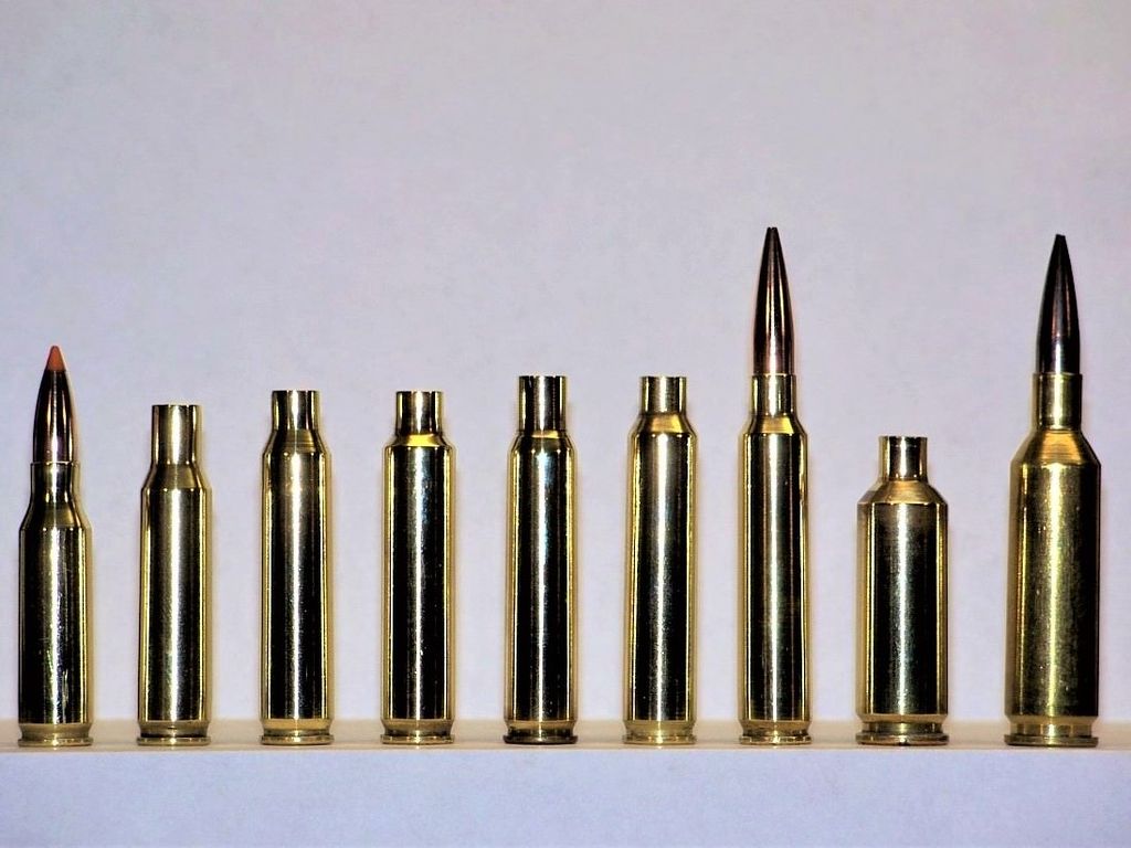

22-204, slightly more capacity than the 223 AI, no fireforming and readily available brass, think of it as a 222 Rem Mag Improved. You can even load with off the shelf dies.
L to R
221, 222 Rem, 223 Rem, 223 AI, 222 Rem Mag, 22-204, 22-204/80gr VLD, 22 Dasher 22x47 Lapua.
Photo curtesy of alff
