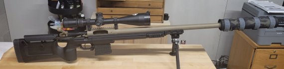

Looking for metal Box magazines on the AICS pattern, I have several polymer MDT but I'm looking for metal magazines that fit an MPA chassis. They need to accept a 2.40" oal cartridge.

Ordered an Accurate Mag 223 metal box mag and loaded up some 2.36" 224 Valkyrie. AICS pattern.
They all cycled chambered and ejected. Next up I'll take it to the range.
If that works, I'll do a full report.
Looks promising....
