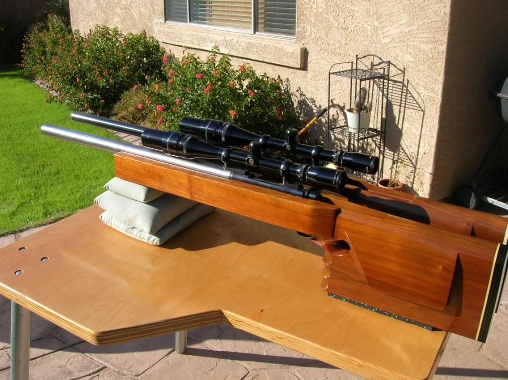

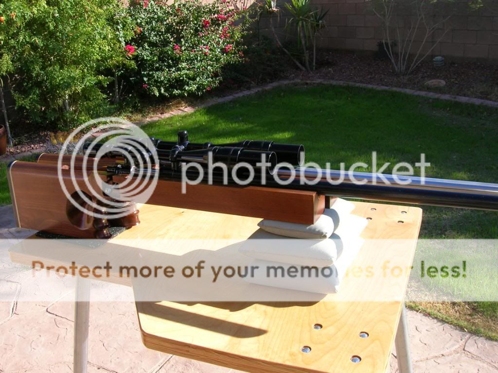

Hi Lee , I started this a long way from the center of 1K benchrest coming from Australia .. Basically went in an evolution process building our own stuff along the lines of what seemed to work and diced what didn't .. Used a combination of metal and wood for the stock hand laminated pieces of ductile alloy sheet .125 thick and 7ply wood approx .350 thick .. Added two solid alloy pods at the front onto the 3.0 in wide stock .. Your complete hand fits inside the stock where the trigger is housed . Action is a one off 2.0 in dia magnum drop port and conventionally beded(Glued) , barrel is 1.500 tapered profile with a 2.00 dia x .190 wall 6061t6 tube to take up the barrel tension .. All up is 68lbs .. cartridge is my own design based on a 300wm ,30thou shorter, 70 thou longer neck ,35deg shoulder and a std body taper, 92gns of h20 capacity.. Good luck with your new Heavy ..JR..Jeff Rogers

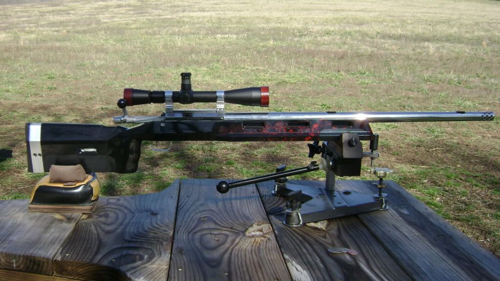

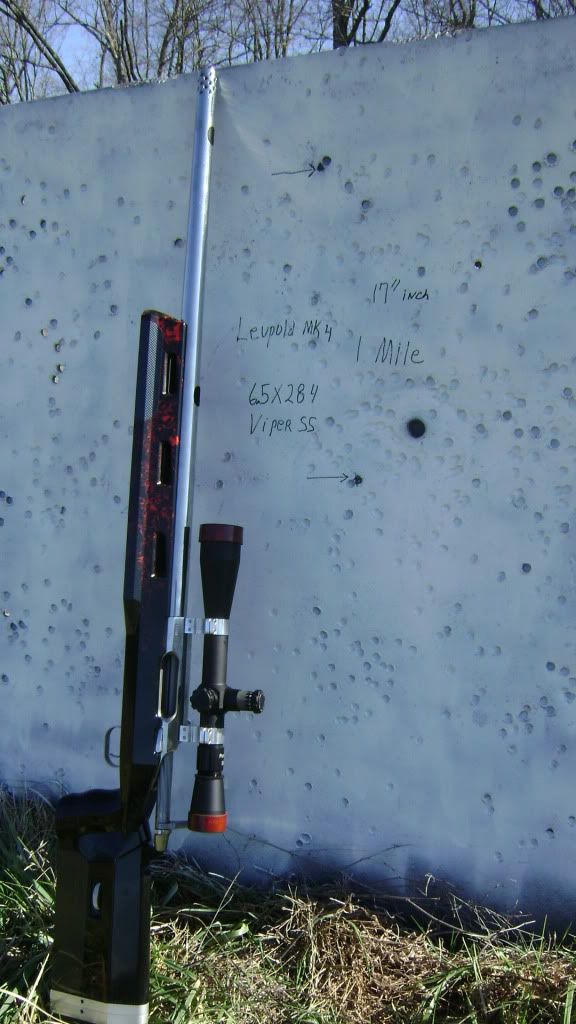

S & S Precision 6.5 x 284, Viper SS,
One Mile
Savage Target action....no taper Pac Nor 6.5x55 28" 8 twist
scope is now a 6500 Elite Tactical 4-30x50....
18.6#
