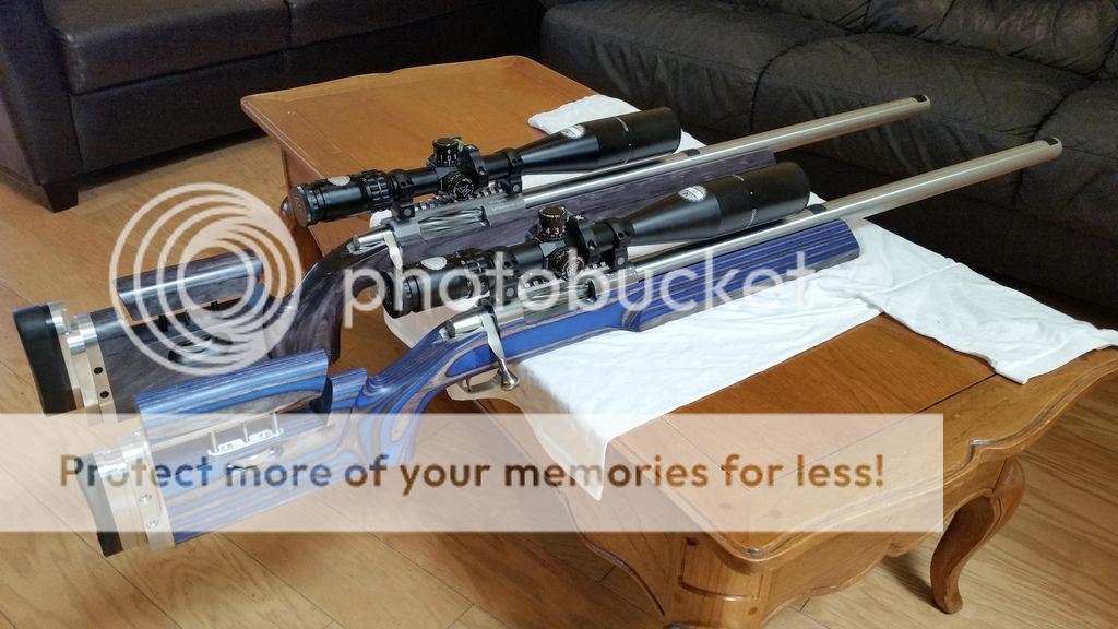

Bat M Multiflat - PR&T Lowboy - Bartlein 32" barrel - NF Competition FCR-1 - NF Ultralite Rings - Jewell Trigger - 284 Shehane/6Dasher/338Edge switchbarrels
Bat M Round - Masterclass F-Class Modified - Bartlein 32" barrel - NF Competition FCR-1 - NF Ultralite Rings - Jewell Trigger - 284 Shehane/6Dasher switchbarrels

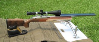

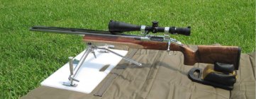

I thought I'd join in the parade. Here's my latest .308 rig:
Kelbly F-class Panda action LBLP
Kelbly trigger
Shurley Brothers stock
Bartlein HV 30" 1:10 5R
March 10 x 60 scope
Kelbly medium rings
Joypod by SEB
Build by Omar Alonzo in Pasadena, Texas. 170 rounds down this tube. First time in competition will be this weekend at the TSRA F-class Mid-range match in Carthage, Texas.

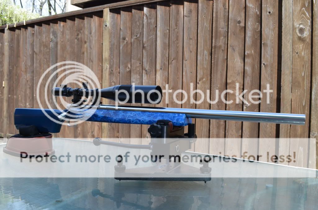

My F-Open 6 Dasher.
Blueprinted circa 1971 R700 w/oversize one-piece bolt, bushed and sleeved firing pin, Tannel light steel FP assembly
Brux straight 1.250 / 8 twist / .236" bore / 29" muzzle to boltface / .2704" nk / .104" FB
Shehane ST1000, Jewell 1oz, NF 20moa 2-piece base, Leopold MarkIV steel rings, NF 12-42/56 BR w/2NP-2DD
Farley up front, Edgewood in the back.
