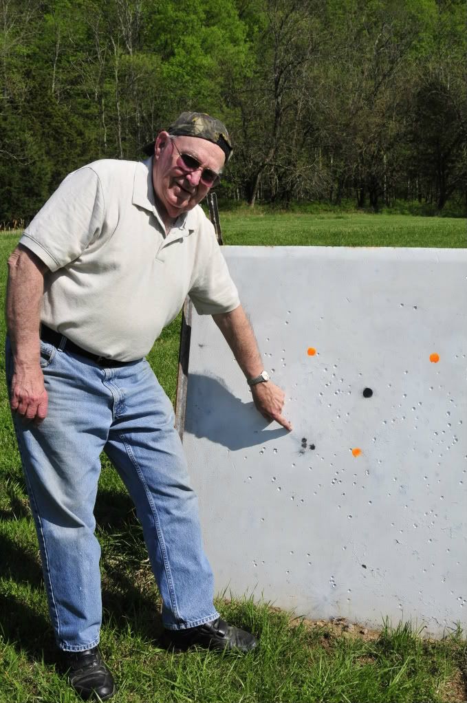

4' x 8' steel plate. Takes a tractor to move and set up.
Tom Morley with his 1,000 yd group.
