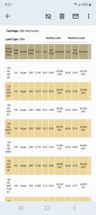

I recently asked Hodgdon why there was no data listed for Varget with 185gr. They sent me all the Varget data for every 308 bullet. If you need data for something heavier than what's in this screenshot, let me know.
