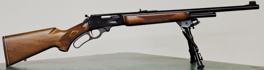

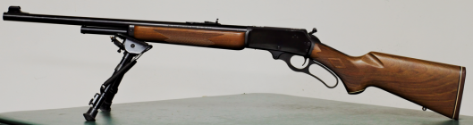

Here's the guide gun I used that made me build the 450. It's a factory Marlin 444 (JM) and I carried it for years as a guide gun and it worked fine. It packs as much punch as the 45 7- guide guns but bullet selection is critical. One day I had to come up against a heavy grizzly and it didn't break the shoulders. I was running hard cast which up to that point had worked well.
So, I built the 450 and left the 444 to use only in areas where there would be no big boned bears and for deer. For deer it's great when you hunt crowded areas, and you have to try and stop them 99.99% of the time immediately in their tracks. The 444 is why I don't have a 30 30, as far as deer or short-range elk go, they fit the same purpose.
