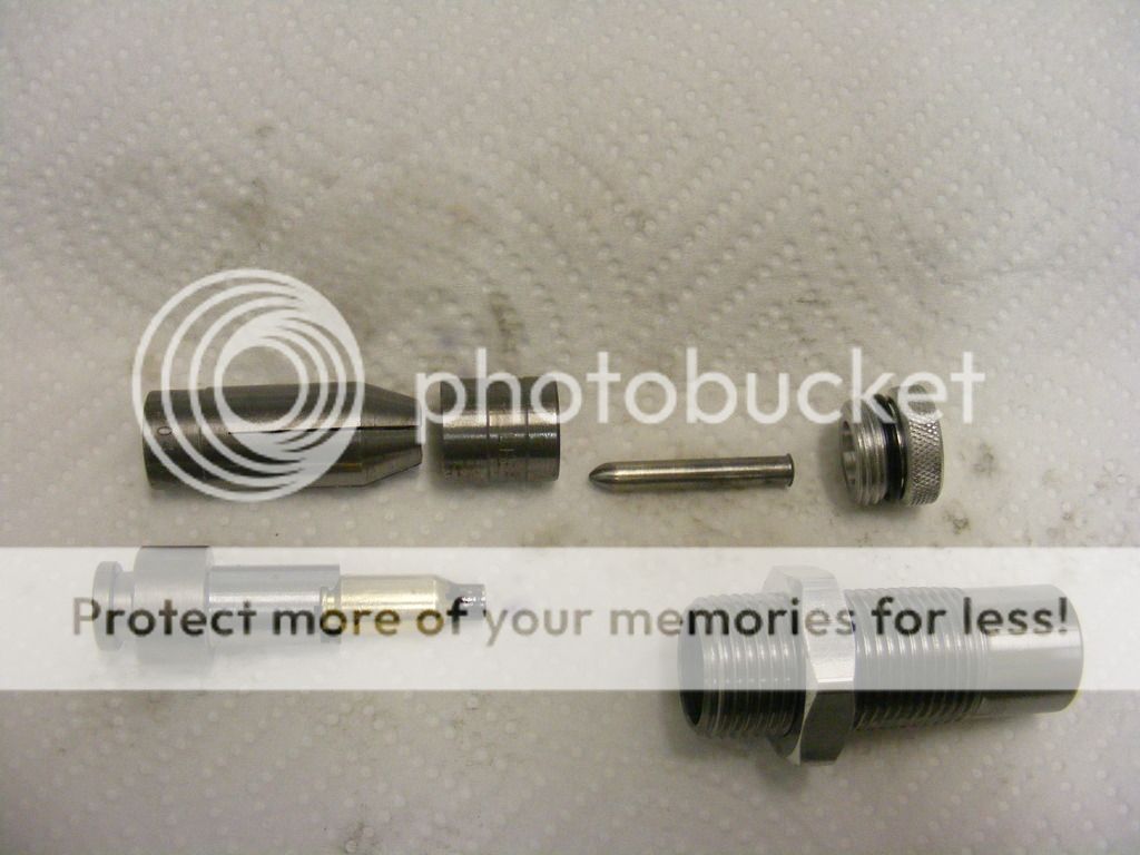

That is the 'extra tall' RCBS #10 extended shellholder. Std carbide tooling will cut it just fine, its not anything unusual or special. Since the shellholder has no decap hole I shortened the mandrel. Zero modifications to the rest of the 204R die parts.
How cool is that?? Looks like "You're THE MAN"!! Amazing what you can do with the proper tools/machines and a little thought.:cool::D
I modified a Lee 204 collet die just like GrocMax and 20 Tac described and it works good. But I prefer to full length resize so I ordered a custom bushing sizer from Whidden last week for $114. In the mean time I'll be using a Hornady FL die.
