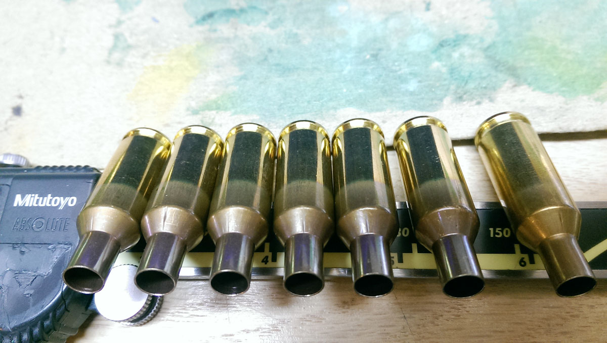

I have gone through about 700+ rounds of new Blue box Lapua brass in .223 and 6BR and haven't found a single unusable case. Had a couple slightly dented necks but they loaded up fine. Guess I am living right these days.
If you have gone through over 7 boxes of Lapua 6BR brass and haven't found a single piece with the shoulder fold, then yes, you are very lucky and in my opinion should begin playing the lottery and think really hard about a trip to Vegas.
I would anneal all of the cases that look OK before using them. There might exist high stress levels that have not yet resulted in cracks. It's possible that cracks may appear after shooting a few times. Maybe the Lapua Rep can comment on whether annealing would be good insurance. Did Lapua annealed them after they cracked and missed the problem?
This is the issue of concern. Take a very good look at the picture below and you can see all the folds on the shoulder. All the folds are the weak spot. Lapua WILL take care of this...
Out of 300 that I checked over the weekend, I had 2 out 300. I might go through them again to make sure I didn't miss any as I don't like to go through the process of requesting replacements multiple times for one-sy-twosy's
an i thought my chamber was doing that [the picture above] i didn't inspect new brass when i got them, i guess i just learned something at 71yrs ole my eyes not all that good... i have a bunch like that they still seem to shoot ok... i guess
I had a whole batch of Winchester 270 wsm with those shoulder flaws, some went all the way around.They were replaced by Winchester quickly !
Huh! I didn't know you could get the bad ones replaced. Like others said, I've found one in every other box of 6BR (10 boxes so far). Only 1 bad one out of 500 6.5x284.
Just checked my two new boxes of 6mmBR brass. Of course I've got lot P00726201 that DJ commented on a while back and saw a few with folds already.
