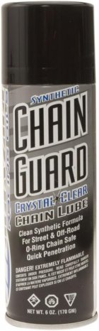

I ended up using clear synthetic chain lube. It stays wet and stays on the gears. I used it on the open bearings that support the shaft that transfers power from the input to the output gears. It quieted the sound from the gears considerably. Getting all the gunk and chips out of the gears is what it really needed.
Exact product I've been using for a decade. Tacky enough to remain on the gears for days, but won't hold swarf.
