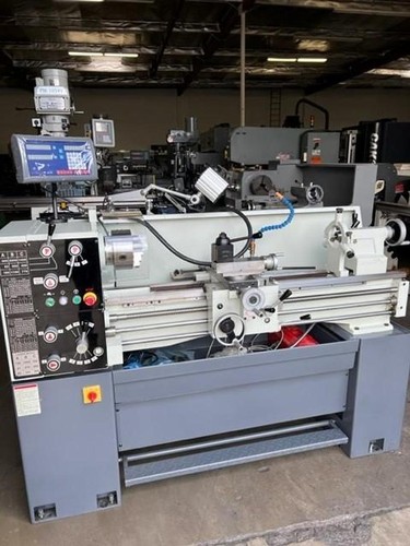

I am considering a Trak CNC/Manual. Full CNC with easy teach and also functions as a manual.
That's really nifty.
The chip tray, or lack there of looks kind of annoying.
Not sure what's going on there. Says
"Complete One Piece Base with Built In Chip Tray (Your choice of heavy duty steel, or upgrade to cast iron, please choose appropriate model)" and it comes with coolant system so must have something fluid tight.
Might have to make a removable tray but couldn't put right up against the wall.
Yeah, looks like it's water tight on the back side... but that low wall on the back seems silly. I can see making a huge mess behind it... then again, there's a huge mess behind my lathe anyway.
