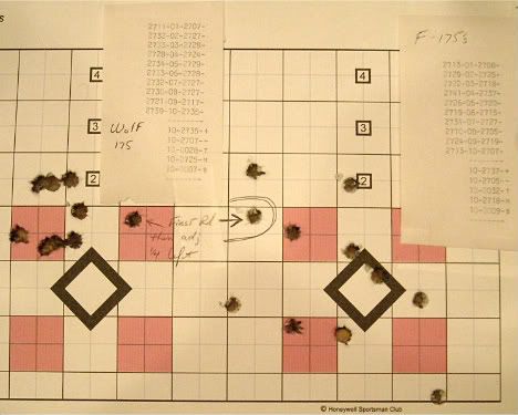

Perhaps the single greatest difference I have witnessed is this test I did for a moderator on another forum.
If you notice the tapes from my Oehler 35P the SD for both was under 10, rounds fired at 300 yards, .308 Winchester. The only difference was the primer for these 2 ten shot groups.
Draw your own opinions... it was an eye opener for me.
