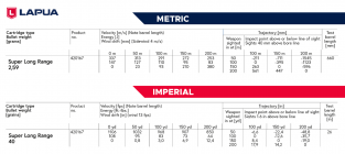

I am going to assume the only difference between the LR and SLR is sorting as the specs and drop chart are identical. What I found interesting was comparing the new offerings from Lapua to the SK Long Range Match. I have attached screen shots for all three and would imagine these are all the same cartridge with varying amounts of sorting.
So says Lapua? Reference?
