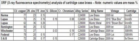

I don't know if by "Gold Box" you're referring to their old Brown Box cases or what. Anyway . . . maybe the pic below will give you some idea whether it's a smoke and mirrors thing or not.
The data is from an article on accurate shooter
and is a good source of information. The brass used in the "Brown Box" is especially puzzling since it is not normally cold worked but hot worked. Both C240 and C260 brasses can be used for cases and the choice is most likely based on cost as copper tends to be very volatile. That is probably why Lapua used Muntz and boxed it differently so its use would not reflect negatively on the "Blue Box".
There was a thread this article came from here on the forum. There was lots of interesting discussion. And there is no doubt Brown/gold box is different than blue.
