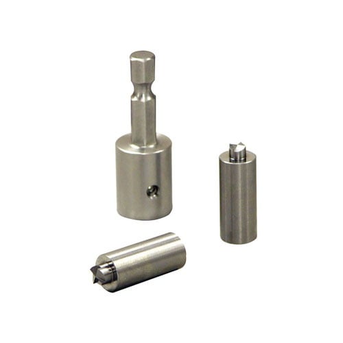

I had the same issue with Lapua .223 brass about 8 years ago. I bought a k&m primer pocket uniformer to fix them. I now have a Benchrite uniformer from PMA as well. The K&M uniformer was to big around to fit inside Alpha primer pockets. I prefer the benchrite tool now, but they both work great.
Thank you everyone for your replies! They've been very helpful. I learned that 21st Century makes a micrometer uniformer, so I'll be ordering one of those. I really like that company as I've come to rely upon their mandrels for setting final neck tension. I'm looking forward to truing the pockets in this out-of-spec Lapua brass so I can do my fourth and final ladder test, finding my seating node. Thanks again everyone.
I have that uniformer as well and while it's a good tool it will not leave the side wall of the pocket unmolested.
I've got 8-10 pocket tools the PMA is the best for what you want to do.

Thanks! What does it attach to? Would it thread into my Lyman station or does it require a mini lathe like an RCBS case trimmer?
I have a similar tool. I cut until the tool bottoms on the case head. When the case is made the pockets are swaged in. I think this leaves a radius at the bottom of the pocket o.d. Removing this radius and maybe a little from the bottom should help. I think the primer cup o.d. rim bottoms on the pocket o.d. radius not the bottom of the pocket. Since it's a swaged pocket I would guess the bottoms of the pocket are not flat. The flash hole is also punched in, not drilled. My tool does not make the diameter of the pocket bigger.

I also use a SINCLAIR primer pocket uniformer so all primers are below flush and seated to a like depth. Hope this helps.

And be careful when using an adjustable depth pocket uniformer. The set screws have been know to loosen allowing the tool to just keep a going down into the pocket. For this reason I prefer fixed/one piece carbide pocket uniformers. An old cordless drill with a weak battery seems to work just fine for uniforming.
Frank
The Sinclair primer pocket uniformers are precision ground from one solid piece of tungsten carbide, so there is no need to worry about changing the depth of cut. These cutters are designed to be used every time you reload. They cut the depth of primer pockets to the correct SAAMI specification and also clean the carbon out of the primer pocket after each firing. Available in 4 sizes: Large Rifle, Small Rifle/Pistol, Large Pistol, and a PPC/BR uniformer.
I just haven’t been able to make a unadjustable uniformer work on all types of brass.
