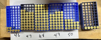

After receiving a case of Long Range, checked the dispersion of the rounds. It took three boxes to get to a full box of the same number. I believe that there is enough outliers to cause fliers in a group. These numbers are not the numbers that I generally get, because stupid me dropped the gauge and broke the indicator on the gauge. So I had to use one with a shorter stem. Consistency was still there, just a different read out on the new gauge.
