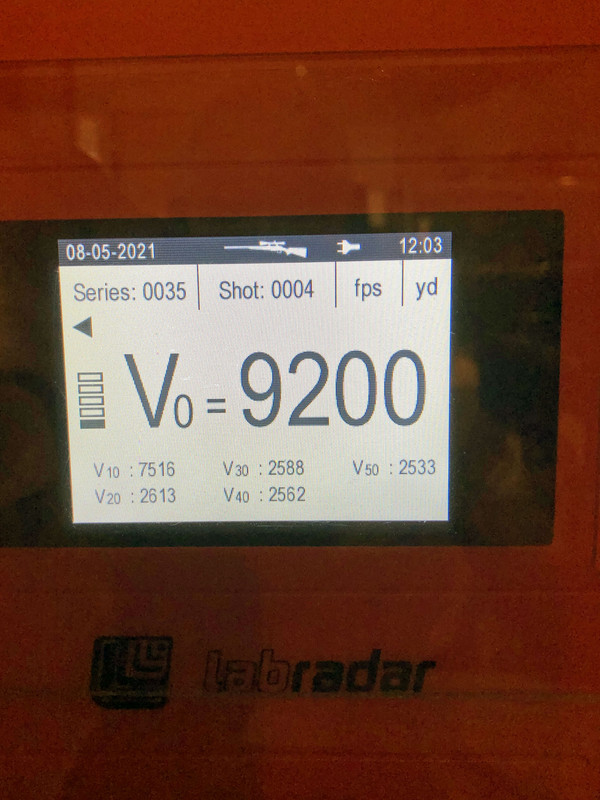

Well I just checked out their website and damn, it kinda sucks that it stops at 3900 fps. I'm working up loads for my 220 Swift and not sure this is gonna work.
Mine can measure to 9,200 fps.
Wonder why the limitation of 3900 fps? Is that a shortcoming of Doppler or is it something that has been predetermined by software limitations or something else?
