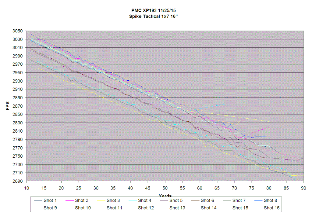

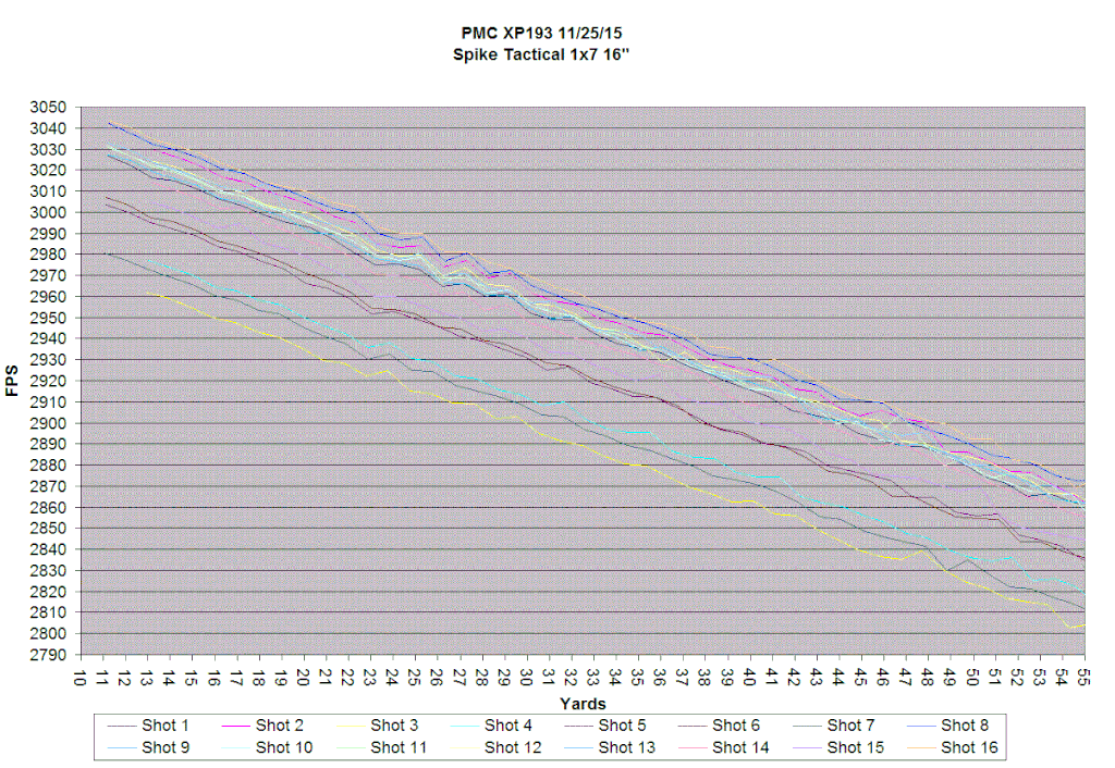

See if these show up some of my very first testing with the unit.
50 yards plot
90 yards plot

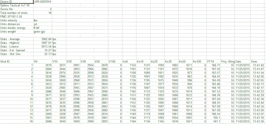

Stats File

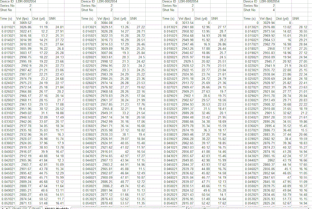

Sample of string data
