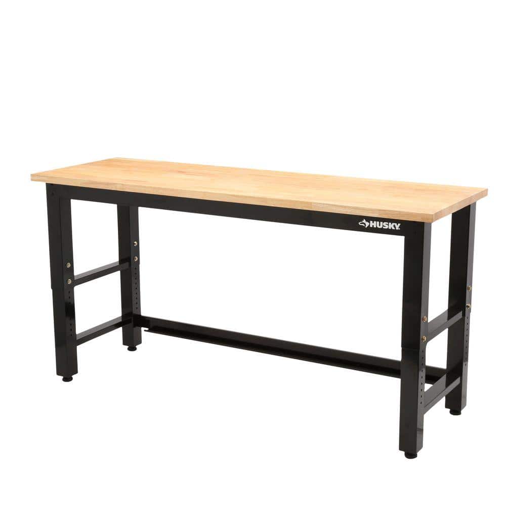

I’ve moved several times since constructing a “built in” a 2X4 loading bench and decided to buy one that’s rugged, rigid, and easily transportable. I use angle clips to attach the rear legs to wall studs.
