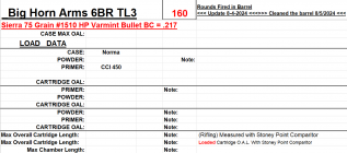

For me Excel is the easy button for recording and tracking my shooting data. What I like most about it is being able to sort that data in such a way for comparisons. I used to save all my targets with dates and some data on them, but I find I don't need the pics as long as I have the data from it (like, group mean radius, ES, MOA, distance fired from, etc.). And if I need to make a unique note for a particular piece of data, every cell in the spreadsheet can easily attach a note. Also, I can have various sheets with different information that I access with the tabs at the bottom. These other sheets contain information collected from various sources and can be pictures as well. Over time, I've added columns for additional data I want to tract and added tabs for various related shooting information. . . all makes for easy access.
Here's what that looks like (and note the little red marks in the Primer column indicating a note has been entered that I can read just by clicking on it):
