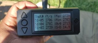

Egh ok so far , haven't been able to really put any work into a decent load. Brass what just some old stuff I had lying around,no clue on the firing sized it all enough for it to fit. And cycle without at lot of extra work to the brass . Just look to see what powder I had that would get me up around $2600fps found some 100gr ELDM's . Really these where more " hay let's see if this thing blows up !"
