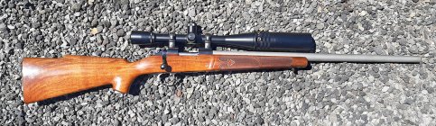

I actually just loaded some more 222's to test seating depth of 50 Vmax, using 22.2 grains of LT-32, and had to use a Forster drop tube, and jiggle the cased before seating the bullets. My barrels is a Hart and not the original Bofors steel, so should not be a problem.
