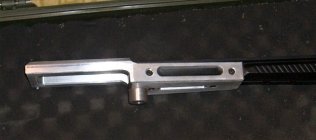

Just in case, I put one on the rifle itself. I should have made
it square so no one would think it's a roller.....LOL Either way,
it's different, and frankly works quite well.....:cool:
