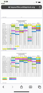

.... when the wind is big, TR lags, that is. We must have had a lot of wind because even at 600 there was a significant difference in scores.
The 20 shot records at Bayou are very close between TR and Open, though.
We did. That was sustained 20mph, gusting 30mph. I remember holding target frames still while sling was shooting, and I remember my TR rig literally rocking in the gusts.
Look at the team scores from the day prior. Calm conditions...the winning TR team was off the winning open team by 1 point...and that open team was stacked.
