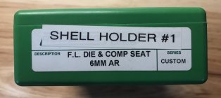

I had my wife take some photos of what I have at home. Do these look like 40deg shoulders, meaning Turbo 40?
Yes, Redding makes the dies. I spoke to them and they said I have to order through Mr Whitley who has the proprietary tooling, he send it to Redding with my order, then they send the tooling back to him with my die. Crazy.
I talked to him or his son a few years ago. In the last 6. They was super expensive to buy through him

I have a 6AR, bought from Robert Whitley in PA. Fred / Sabreco did the chambering, etc. It is a 6.5 Grendel necked down to 6mm. When I bought my upper, Robert sold the die set as well. Redding. It is a remarkably accurate rifle. Bartlein 1:8 bbl. I used H335 and 75g Vmaxes, AA brass. Let me know if you need starting load data.
