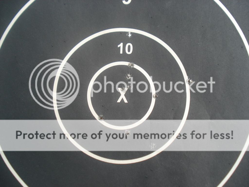

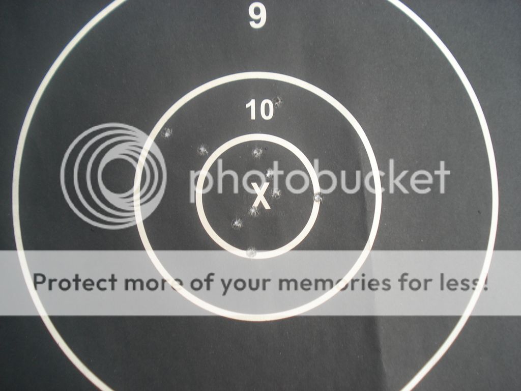

Is this decent shooting? It is a Savage with a $200 dollar EABCO accuracy barrel shot at 500 yards in 90 degree heat in under 10 minutes,, with no pits and no way to see the bullet holes unless I cut a line.
I was good for 3rd place that day lol. 6br with Hornady 105 hpbt's.
