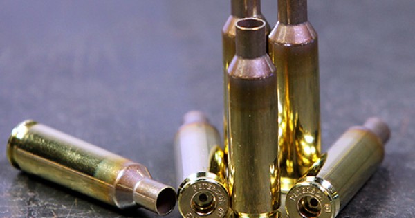

Is 6GT worth the "upgrade" from 6BR?
Want to build a new rifle on a TL3 action, mostly for steel shooting out to 1k yards. I currently have some 6BR reloading supplies (dies, bushings, and some other things.) If I were starting from scratch I think I would favor the 6GT since I can hit a higher velocity, use H4350 powder (I have a lot), and maybe it feeds more reliably. Seems like the GT should get me an extra 100 to 200 FPS faster than the BR. Thoughts?
im running a 6gt, its currently doing 2950 with 34gr varget, 108bt, cci450, in alpha brass in a 24" m24 profile
it holds 1/2 moa out to 600yds so far. feeds well from an aw mag using an arc cdg action
