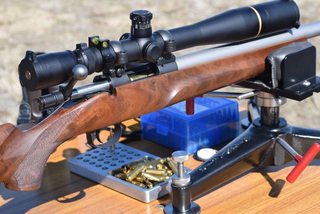

Bolt open, barrel cooling, loaded round ready for the next target to appear:
I prefer loading one at a time. To me it much simpler, less disturbance on the round, better way to keep heat down between strings. I have never shot a left port setup, but it makes sense when shooting off a bench in a rat patch.
^^Yes^^… I shoot Bench Rest and am a reloader, so I prefer single shot, Right Bolt, Left Port, Right Eject. Want the cases going out the right side, captured on the bench. Load from the Left, of course.

My LR Rockchuck rifle are single shot RBLPLE. Right hand opens/closes the bolt, left hand catches the empty, sits it in the ammo box, and then reloads. I take three rifles, and switch off about every ten rounds.
