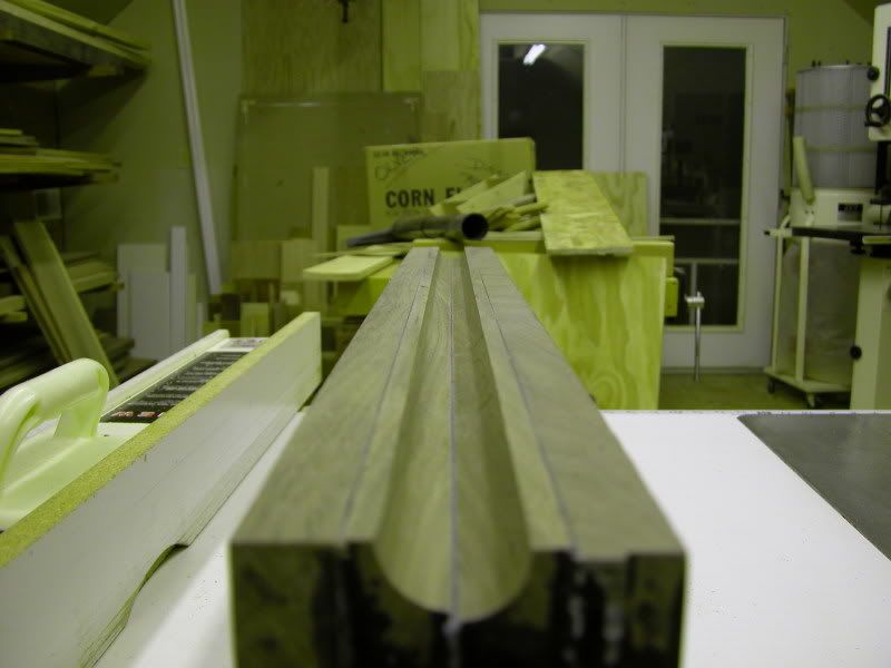

I also use router bits but use them in my (woodworking) shaper with the stock turned upside down. This was my latest purchase for a barrel channel. The Freud cutters are not the cheapest but have an inclined cutting edge that produces less tearout and an overall cleaner cut. It also tends to pull the work down against the shaper table.
For stocks with a tapered forearm, an easily constructed U-shaped guide allows the shaper fence to produce a straight cut.
I have heard that you can also use a vertical mill but that would be too easy. ;)
I've done the exact same thing with success.
