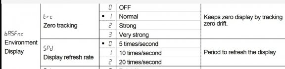

Page 39 of the Fz_Fxi manual.
10.3 Details of the Function Table
Environment Display - Zero tracking.
Also, if you use an aftermarket measuring pan, make sure it is not magnetic. Same for the surface you have the scale on.
And, remove any aftermarket platten covers or draft shields. They tend to pick up static very easily.
Thank you. So, will settings 2-3 allow for a more 'aggressive' auto-zero?
I don't know. I have never screwed with it, and on the default 1 my scale auto-zeros fast enough for the V4.
Just check wat yours is. If it is "0" you know what your problem is.
