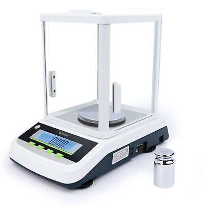

I’m looking to upgrade from a beam scale. Not spending $555 on an fx 120i. I am going to throw a charge and trickle up. I was looking at a creedmoor 925x for $250 but that is a stran gauge and as I understand doesn’t settle as quick. Would a gf series with a magnetic force reduction be better?

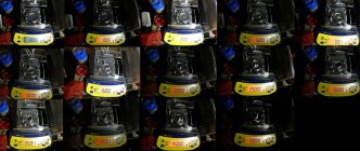

With my EJ-54D2 I can change the cal value, like 10 gram cal on low range.
Linearity is no worse than a count from 1 to 10 grams (or grain equivalent) checked with some pretty darn good standards.
High range
Low Range calibrated @ 10 grams
While "sameness" of a check standard has value, absolute "weight" (Mass corrected for local gravity) as verified with adequate standards might be needed if your favorite nickle is lost or spent :)
