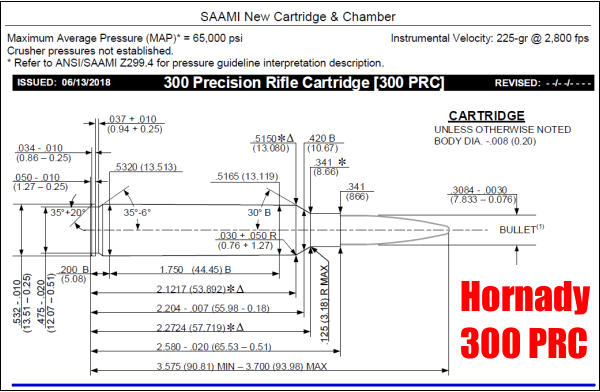

I have a Surgeon Scalpel in 300WM that I shoot 230 Berger's thru. I've always felt the Berger's needed more than the 10 twist for targets out at 1,000 or farther. I have a couple 30 Caliber blanks, one 8.5 and one 9 twist, and have plans to put one to use as a 300 PRC. I have Atlas brass on hand for the project already so it will be adios to the belt!

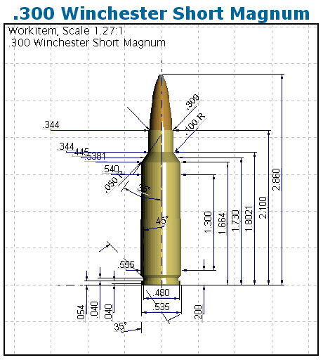

Give Surgeon a call to see what they suggest. Not sure how much work it would take to cycle WSM in a WM magazine. here are the body dimensions
300 win mag body dia .513
300 wsm body dia .555
338 Lapua body dia .587

Good information! But I would think the body diameter of the 300WM would be larger than .513 measured at the belt?
I can measure and make sure of the 300WM but have no 300WSM brass.
I have to use the 338 mags for my 300 Norma Mag for body diameter instead of length.
you are correct
300wm is 5.13 body and .532 belt

300PRC for member shoot4fun...cheers
