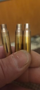

Sorry if its a dumb question but what is zero annealing? How does your 750 tempilaq react when it hits temp? Mine just turns kinda dark. It doesn't have a very clear melt like my 450 does. My 1000f just turns darker red.

Should my cases have a darker color to them. I dont have anything or person to measure the hardness. I am here to learn
Annealing color change means nothing other than the surface of the brass was oxidized and got hot. :)
Webster is correct. Getting to 750 won’t anneal brass in seconds. Getting to that dim red glow with the lights off, which is around 900F. Brass annealing temp and time needed have an inverse relationship. The hotter you go the less time you need. I don’t have a chart infront of me, but as an “about” it takes brass about an hour to anneal at 600F, a minute or so at 750F and in the seconds around 900F. That’s not an exact science, but close enough.
When folks in the past have been using templaq they were letting it get hot enough to where the templaq melted 1/8-1/4” below the shoulder of the case onto the body. In that case, no pun intended, by the time then templaq melted 1/8-1/4” below the shoulder the neck was certainly way hotter than 750 and closer to the 900 mark. Annealing brass your trying to isolate the heat to the neck and shoulder which is why you want to heat it up so fast. That being said, the templaq method isn’t needed. Just use the dim glow method and you’re good.
Lastly I will say with induction annealing it is incredibly important that each piece of brass is centered in the coil and placed in the same height. Once induction starts it will self center the brass, but it can’t self center the height.
As said above, the color really doesn't mean anything. Though what you see is an indication how far the heat had traveled down the case and from what I see you're I'd say ok with regards to this. Even with an induction annealer, the "glow method" can give you a good idea how hot you're actually getting the necks to.

This is exactly the info i needed to understand and will learn from. At times i had brass that turned dark and was worried that i did to much but this was from fired brass. Maybe carbon I believe would cause that. I do my best to keep the brass centered and have noticed if it isnt one side gets hotter faster. I drink lots of coffe when i am annealing lol jk. Taking note of this in my book. You would happen to have a picture of what correctly annealed brass looks like. Just curious is it makes a difference with the surface color looks like. Thank you fot the info
