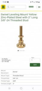

Shame they dont have those in fine thread.
I could make those work...
This is a great idea , and to make the blocks "floating " and captured you could radius machine the jack bolt and block then machine a clearence counterbored loose fit capture screw from the bottom ?
