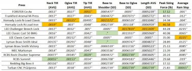

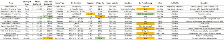

It's an eye opener when one looks at comparison data presented like this:
Lol. Love it. I can’t tell you how much time I’ve spent pouring over these exact charts and this single stage press shootout site. Really great article.
