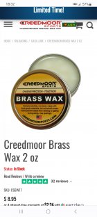

You might try the Hornady one shot wax in the tin.
