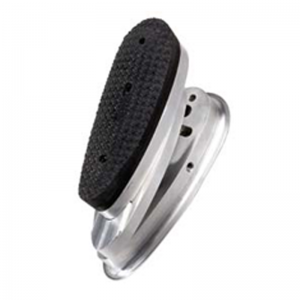

Edited to add: if you look at some of the three-way adjustable rifle butt plates (link below), the pad/plate that contacts the shoulder can often be tilted/angled as you have tilted/angled the entire rifle in your picture. It's possible that tilting just the butt plate that contacts the shoulder could provide the "feel" you're looking for, without having to tilt the entire rifle. Something to consider, anyhow.
You are spot on! I reset my scope square and plumb to the leveled receiver, then I did a little magic to my AR style buffer tube to be able to cant the stock to fit my shoulder and presto!! I am going to try this in the field shortly but it feels right when shouldered and scope alignment is there. Thanks!
