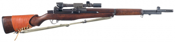

M1D's had scopes mounted on the side. Your set up will work but you may have to add a click of windage in at long distances.

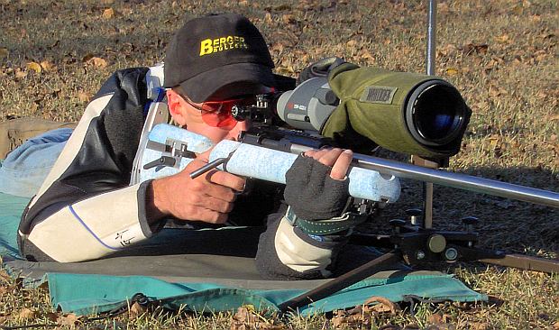

You can see in the Whidden photo he cant his rifle however you will also note he has set up his sights to be perfectly vertical over bore.
Whidden canted rifle
