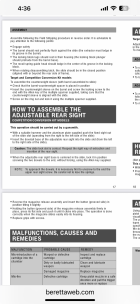

The rear sight is tapered to make it harder to go deeper that direction. A quick glance at the manual, they want you to buy the target sights. Those have dowel pins under the elevation screw.
Looks like the Competition Conversion Kit rear sight also requires a much taller front sight. Beretta does have a lower profile adjustable sight on the web store but it's not my first choice. Originally I started looking for one like the picture below which I think ison the Beretta UK site but not US.adjsight.jpg
