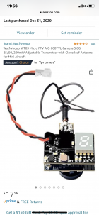

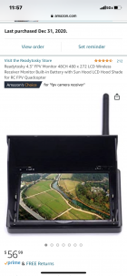

A shotMarker would be really nice but expensive. Look on YouTube for FPV cameras. You can build a nice target camera for less than $100.

This topic was covered before. Here’s a link o building your own camera.
Yup, did the same thing about 4 years ago. Used parts for FPV, invested about $50.00 for everything.. Good post.
I tried one of these FPV cameras. The one I tried has no way of zooming the image in closer. Had to place it 10” in front of the target making it useless. With the camcorder setup I’ll put the camera about 25’ and off to the side of the target then zoom in so the target fills the whole screen of the monitor. I tested my setup and got reception out to 1000 yards.
