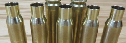

I guess this may apply to any sort of trimmer, But how much of a chamfer to you want when using the Giraud power trimmer. Since the triangle blade can be moved, You can have anything from a mild chamfer or a pretty dramatic chamfer to where the case mouth is a sharp edge. Is either wrong? Or right for that matter?
