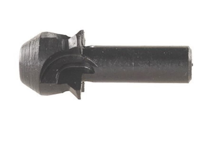

I use a Giraud cutter in my Gracey, and I adjust it inward so the internal chamfer isn't massive and there is a substantial external chamfer.

This will do the job you want with fairly minimal cost. If you get the little adaptor the RCBS sells to allow the trimmer to use a power source/drill instead of the crank handle it is pretty quick and trims, chamfers inside and out in one step. Cutter can be adjusted to the amount of chamfering.
I agree with the above comments about minimal chamfer except for the .20 cal. For that I prefer a fairly substantial inside chamfer to help with bullet seating
