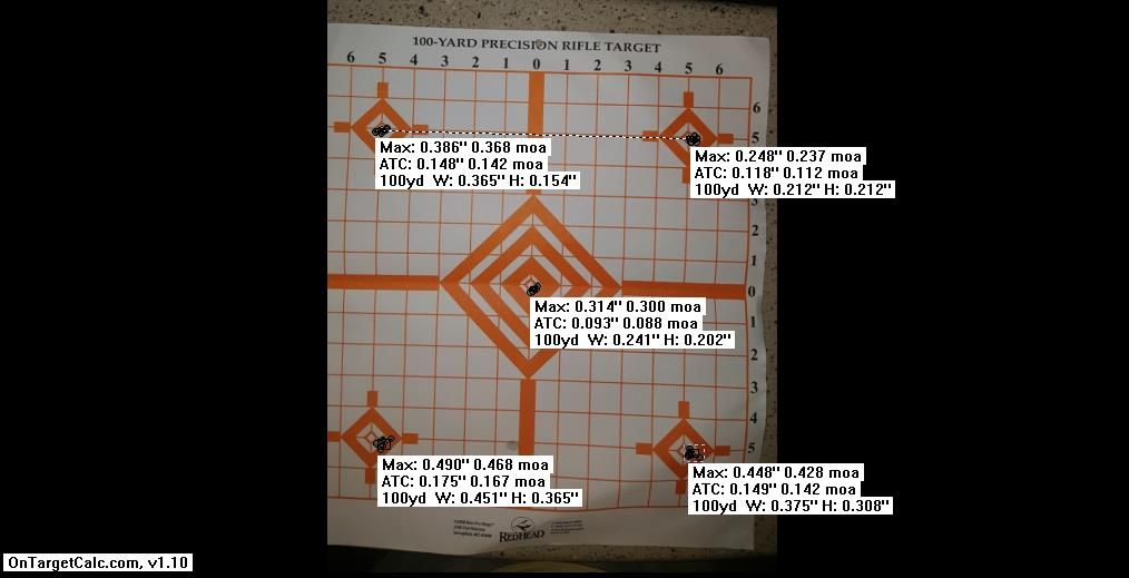

Look 6br's just shoot well. Below is a target shot during load development for one of my savages. This is just after barrel breakin with berger 105 vld's jammed. Powder charges, varget, from 29gr to 30.2 gr. You are just wasting time and components. Pull the barrel and order a shilen select match from NSS and i bet you problem improves substantially.

that is what I expected
never got even close.
