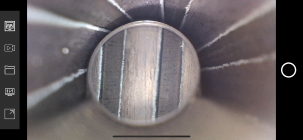

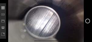

Don’t think is was cleaned in years, my progress so far. The patches started left side going down.
