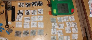

How Many Patches Used When Cleaning Your Rifle?
Far fewer than I used to, probably about 10-12 total now. 2 to 3 patches with my chosen pre-cleaner, 30ish strokes with a brush with my chosen cleaner on it, then another 5 to 7 to clean out the gunk and finally a couple with my chosen oil. In all fairness I use a few more patches when cleaning out the action and inside my bolt so let's just call it 15-17 for a fully clean and ready to go gun and that's the high number.
I clean after every range session no matter how few or many rounds I shoot and I go back to pretty much bare metal every time I clean.
It depends. On the high power rifles about 25-30 patches. On the rimfires about 15 or so. Depends also on if I decide to use a brush also, which I don't always do.
