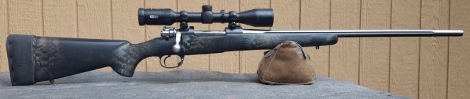

This week in my 55 degree shop, a new batch of Devcon steel putty took 12 hours to be hard to the touch.
This was bedding the scope bases to the receiver, while fixtured with a modified AR15 riser.
The Devcon had been in the house and mixed in the house, but the gun is in the cold shop.
