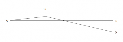

I think I have this correct, in simplistic terms using straight lines.....
From the muzzle at 2750 fps 10 mph direct cross R to L would be .41". From 100 yards at C with a velocity of 2638 fps 200 yards to the target line with a 10 mph L to R wind the drift would be 1.92". If we round those up to .5" left then 2" right, the bullet would drift back 4 times more from the left in the remaining 200 yards.
If I'm wrong oh well, if I'm correct this is a whole lot more than the thread was intended for even trying to keep it simple. If we consider that the wind (air) is both a gas and a fluid and can also have particle matter, and the earth is moving, and the bullet is spinning, I think my head is spinning, but regardless this straight line is most likely going to mislead rather than simplify.

Would it be much trouble to draw the hypothetical scenario I presented in post 27 above, with line A to B included?? I think that will draw a reasonably close mental image...fwiw.
What am I asking? Lol!
Well, you did ask, but apparently I am interjecting more than you want into your illustration, so I will bail out of it.
Nonetheless, @Ned Ludd illustration simplifies wind drift effect.
