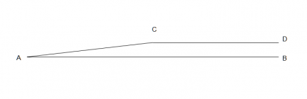

For all intents and purposes here, a bullet doesn't move sideways unless acted upon. A wind at the first "flag" and zero wind the rest of the way will move the bullet essentially like this
-----------------\_____________________________________>>
The only force still at play after the bullet leaves the cross wind is lateral inertia. For a 10mph wind, that would be worth about 14.6fps opposed to roughly 3000fps of forward inertia. Yes, it will have a new course to it's new poi but I can't see how it will maintain an angular trajectory after the force of wind is no longer acting on it. If you've shot over flags much, you know that it's very common to have several flags going in different directions at the same time and that a steady crosswind is much easier to shoot predictably. So yes, if the bullet is subjected to a steady crosswind for it's entire flight, it may appear angular or curved in it's trajectory,
It didn't draw like I intended but I think it's good enough.
Does this illustrate a little better?

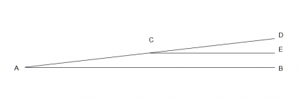

Birds eye view
Shooter at A
Straight line to target B no wind
Constant wind from the right drifts bullet left to D
At C the wind goes to zero bullet drifts to C then straight line to E
Birds eye view
Shooter at A
Pretty much but would be easier to visualize, to me, if the line between c and d were gone, that shows full drift in a constant wind for the entire flight. But yes, what you have shows that just because you have a blow at the bench, doesn't mean that blow is the same down range and won't have the same amount of deflection as if it were for the full flight.
Would it be much trouble to draw the hypothetical scenario I presented in post 27 above, with line A to B included?? I think that will draw a reasonably close mental image...fwiw.

The lateral trajectory of a bullet under the influence of wind will be a curve, not a straight line. If the influence of the wind stops at some point on the way to the intended target, the bullet will continue moving offline on the tangent line to that initial curve at whatever point the wind effect stopped. This is because of bullet rotation, the weathervane effect, and the resultant drag effect that are what actually cause the bullet to move offline under the influence of wind.
